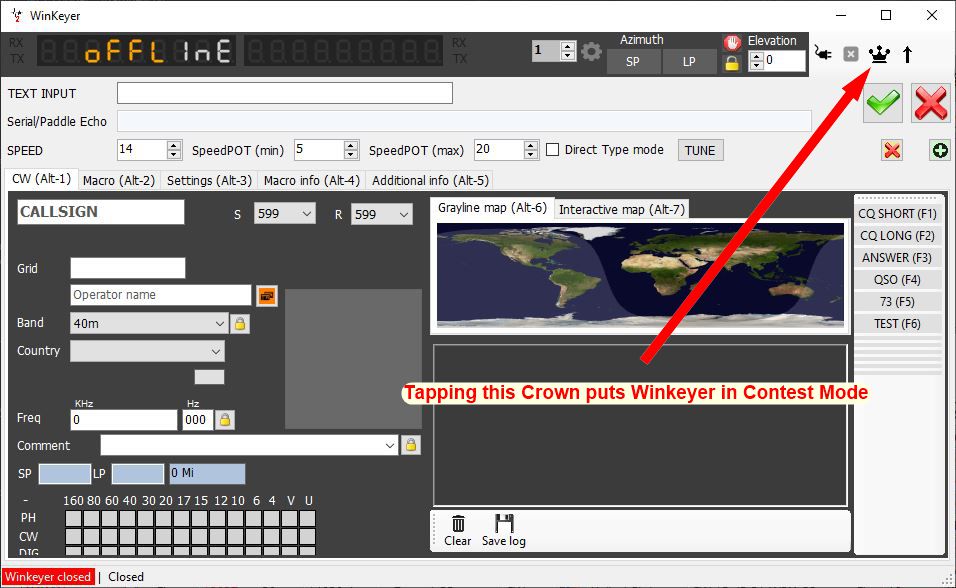

With the Winkeyer panel open if you tap the Crown in the upper right you will be put in Contest Mode.
- winkeyer-panel.JPG (101.87 KiB) Viewed 3399 times

Nolan
Yes I have Contest mode enabled, by clicking on the Crown.
My problem is using Winkeyer window in contest mode there is no indication that the call i enter is a DUPLICATE QSO.
So, if I work N1NA for instance and then log it. If I then type N1NA in again there is no WB4 Indication shown in the Winkeyer contest window data lookup pane at the bottom of the WK window. As it says there should be in the manual. Can you try it to see if it works at your end?

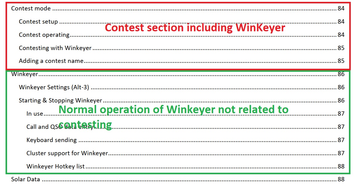

The section you refer to is the normal Winkeyer QSO input not related to contesting
There is no CONTEST WB4 indicator in the WinKeyer window as there is in the Contest window but that could be added at some future time if requested by a few users.
