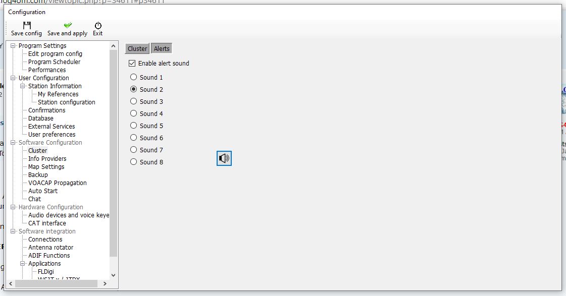

In Settings/program configuration/CLUSTER select the ALERTS tab
Check ENABLE ALERTS and select the sound required
Click the speaker icon to listen to the sound selected
If you hear the sound when the speaker icon is clicked then you will hear the alert sonds

Sorry forget the screenshots.
- Cluster alerts screenshot.JPG (63.85 KiB) Viewed 3568 times
- Audio devices and voice keyer screenshot.JPG (91.61 KiB) Viewed 3568 times
