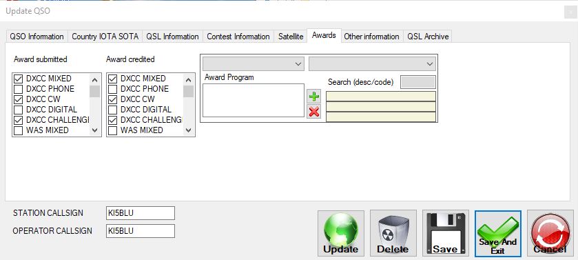

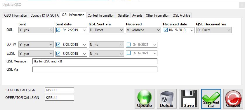

Done the import (ADIF v3), downloaded LOTW confirmations (QSL manager) and still the award totals don't add up. Attached an example - QSO was confirmed via paper QSL, sent to card checker and added to DXCC record.
In V1, I had manually changed QSL status to "verified" and manually selected the Award references to granted (see screenshot). In V2, that shows up as QSL received but nothing in the award references:
In V1:
In V2:
Any suggestions? Any way to import the award references separately from V1? (and first export them from V1?)

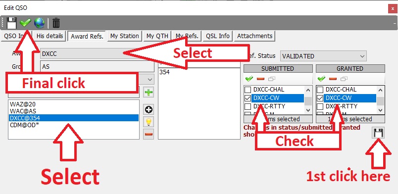

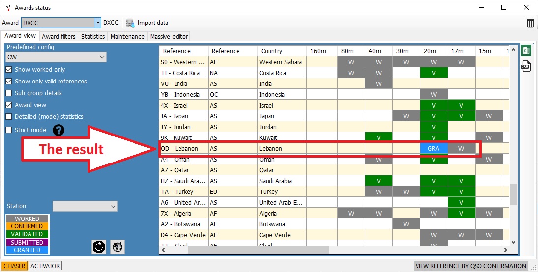

Re: Award references import
Think your doing something wrong because it works for me as described in the user guide

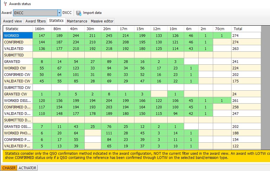

Hi - thanks for the suggestions. I tried but still didn't work. Here's the sequence:
1) Did a full LOTW update (since beginning of time) in V1, everything else looked good; exported into ADIF V3
2) Created new database in V2, imported ADIF
3) Went into Award View, DXCC, mixed. Showed all the worked, validated etc but 0 granted...which means
that the ones that were marked as granted in V1 didn't come over as such
4) Went on the maintenance tab and hit "rescan award references" (BTW I repeated the whole process also once with "wipe award references" followed by rescan - same outcome). Granted still showed 0, everything else same
5) ran a full LOTW import from beginning of time
Result is -- shows 241 DXCCs as granted whereas LOTW shows 271.
If I do a full LOTW Adif download from the website and import that, award statistic shows 259 instead of 241, but if I do another full LOTW download goes back to 241.
I have a number of different station certificates (different QTHs) in LOTW. Could that be one of the issues? Typically TQSL downloads all confirmations, no matter what station cert the profile in Log4OM is set to.
Any suggestions?
Screenshots attached
