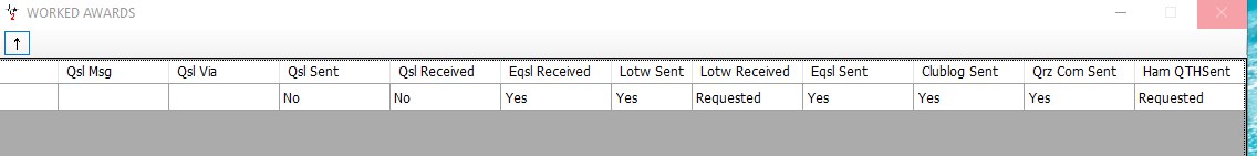

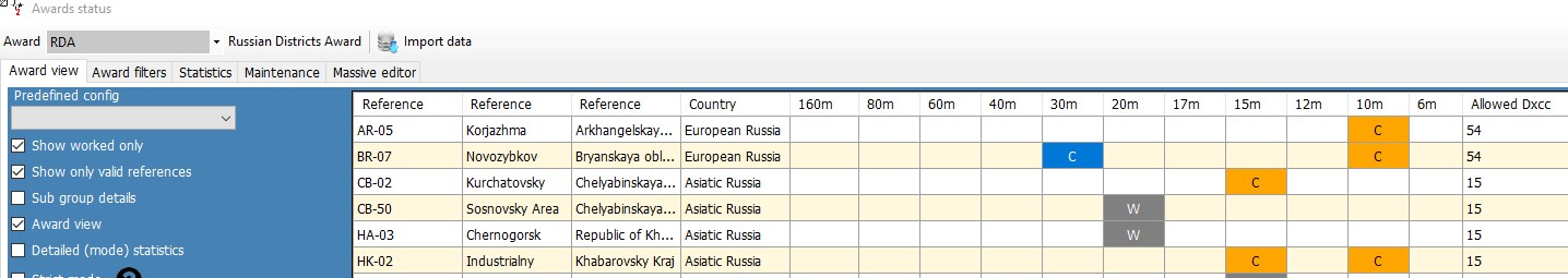

Then I look at the RDA status in "Awards status" and I see for example that I have a Confirmed QSO on 30M in BR-07
I click on it to see the detail of this qso
but I have not received the paper QSL nor the QSL LOTW and why it says "Confirmed"
I'm sure I didn't understand how it works, but if you could explain to me why this QSO is "confirmed" ?

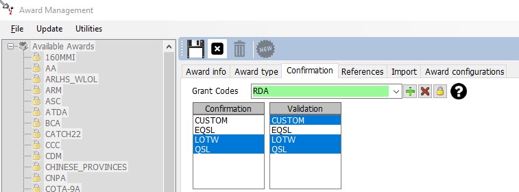

It seems that you have changed the required confirmations in the award manager because the default for this award are as shown below.
If you change the award parameters you will need to restart so that the View/award status reflects the changes that you have made.

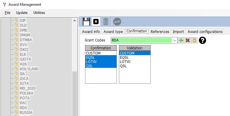

For the RDA only LoTW and QSL xcards are valid, so "Confirmation" should be set to LOTW and QSL. I would recommend to enable the same for "Validation". As Terry mentioned before, if you do any changes in the award please save the award first, then restart.

Go to award status and select the RDA award. Next click on the maintenance tab and then click on the "Rescan Award References" button. Depending on the size of the log this may take some time. Then go back to the award view, everything should be correct now.
Please let me know if this has solved your problem.
