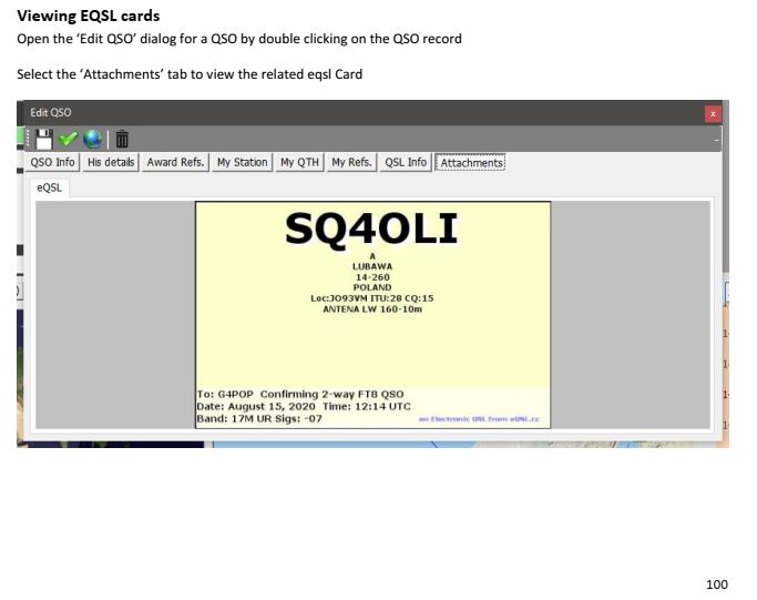

I might suggest that you take the time to read and/or even search the "current" User Guide. On Page 100 of that guide is a very succinct instruction on how to view the downloaded eQSL cards. I've put an image of that page in this post for your convenience.
As for what is viewed in the Main UI Stats (F1) that is part of data collected from either QRZ.com or HamQTH during the callsign lookup. Assuming an OM has put an image in at QRZ or HamQTH that is what is displayed.
That section was NOT designed for a QSL card image. I certainly don't know where you came up with that idea??
And if you follow what we have outlined in the User Guide I don't think you will find it painful at all to view the eQSL cards ... assuming that you take the effort to download them to begin with. That is up to each OM.

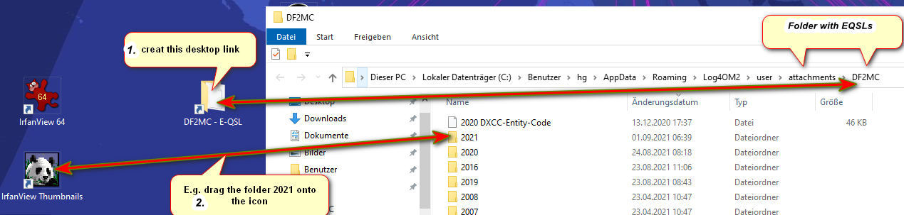

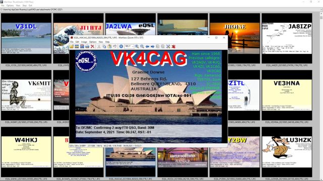

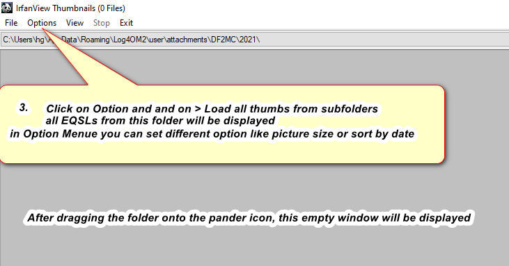

Viewing EQSL cards all at ones and or print out
It is nice and easy to view all the EQSLs in the folder years, or subfolder DXCCs, in a easy and pleasant size.
Perhaps this procedure was already described once in the forum
I use the freeware Irfanview (internet download) with Thumbnails option to view all eqsls from a folder, you can also print them out in Irfanview.
- after installing Irvanview, you will see 2 icons on desktop, a red irvanview icon and a white panda bear icon.
1. Creat a desktop link to the folder with the eqsls. see picture link-desktop
- go to user> xxxx> appdata> roaming> Log4OM2> open user attachment and create a desktop link with a right click on the folder
in my case my callsign.
(if you have defined a different folder in Lo4OM settings containing the EQSLs, link this folder)
2. double-click on the previously created desktop link containig the EQSLs, see picture
choose a folder e.g. 2021 or a subfolder of e.g. 2021 containing DXCC numbers, click and hold the mouse button down
and drag a folder onto the panda bear icon, the empty thumbnail window opens.
3. In this empty window go to Option at the menue bar and and choose > Load all Thumbnails from subfolders > and all the eqsls will be displayed
In the Thumbnail-Option menue you can choose for e.g. picture size, sort by date ....
4. choosing a EQSL at the display by double click, Irfanview will opens this EQSL, you can click through eqsls one after the other,
several option in Irfanview can change the display size, color,contrast, brightness or even print the EQSL out.
I hope the picture can help to setup the apps.
Vy 73 de Johann DF2MC
