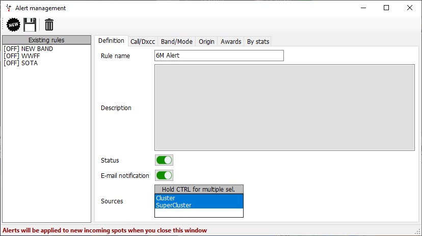

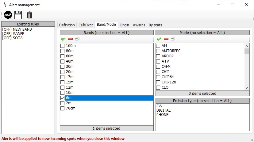

Andy,
You dont say what version number you are using (See Help/About) this might be why the user guide does not match what you see, or perhaps the user guide needs updating?
Anyway I have just followed the user guide to ensure its correct and I set up as shown below and the alert worked fine.
1. Clicked the new button
2. Added a name
3. Set the alert to on including email
4. Selected both cluster and super cluster
5. Clicked the Band/Mode tab and checked the 6m box
6. Clicked the save icon (Floppy disk icon) and closed the alert manager

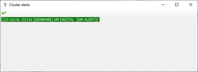

7. Sent a test spot for 6m
8. Audible alarm rang and the Alert warning appeared beside the call sign field which when clicked opened the window showing the alert. ( I also received the email notification)

Alerts now working. Not sure what I did to correct myself. I have it set up to alert me whenever a 6m station shows up on the cluster. Nothing fancy, all I wanted was SSB and CW. The red alert box lights when it should and the alert shows up on the cluster alert panel as it should.
I can click on a call on the alert panel and it will show up in the CALLSIGN box.
