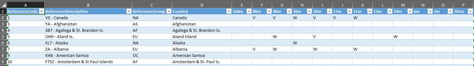

Thats what you requested but if I wanted to view what countries were not worked I would use the provided Award statistics, again as detailed in the user guide but briefly as follows...................
1. Award statistics
2. Select DXCC mixed or whatever
3. Uncheck 'Show worked only'
4. Click either the Excel or CSV button on the right hand edge of the window
Result in Excel is as below
