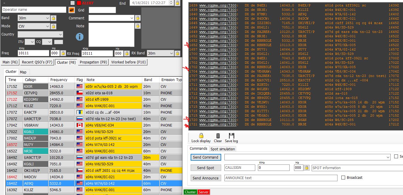

I have been trying to figure out why some SOTA spots don't show up in the Cluster tab. There may be other cases, but certainly the RBNHOLE "reporter" spots don't show up (normally). I don't have any filtering on, but I did notice that if I click the "mode lock" ON they do show up when the radio is in CW mode. However with "mode lock" OFF, and CW, Digital and Phone all checked they don't show up.
I am using the GMA Spider Cluster: https://www.cqgma.org/wwff/doc/DX_Spider_EN.pdf
Image below shows the situation where the RBNHOLE only spots in the cluster management window (see red tick marked spots) don't show up in the Cluster tab. This is the situation with "Mode Lock" OFF and CW, Digital and Phone checked ON.
Note, I think this behavior only happens when the spots come in one-by-one as you are monitoring the cluster. I believe if you do a sh/dx command the RBNHOLE only spots will then show up during the bulk load.
Thoughts?

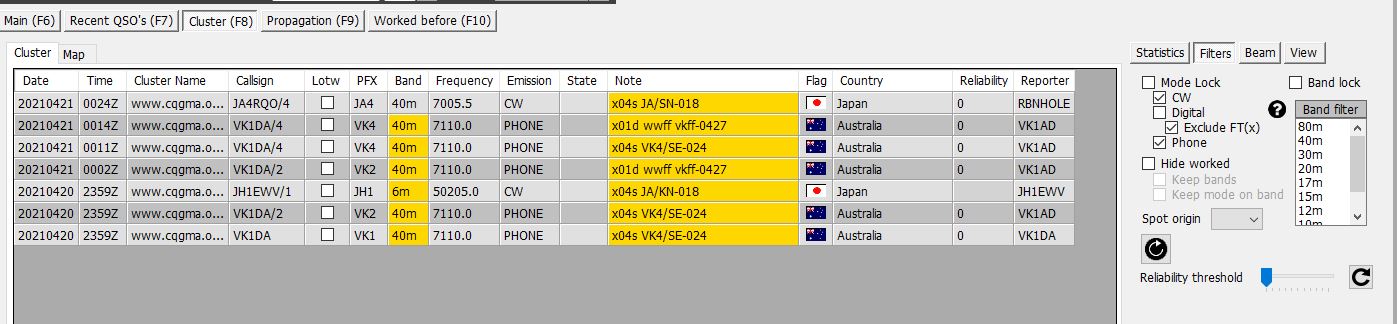

Terry, this is my normal filter setting.

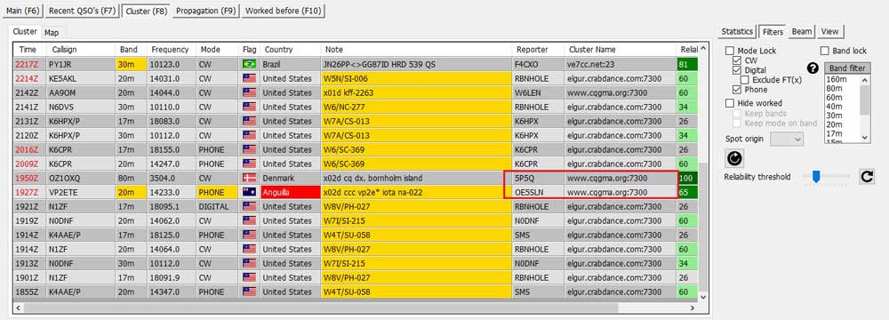

Well I set up for this in accordance with the file that you provided and it all works fine, see below.
So perhaps you have a CQGMA filter set that is stopping the display

I set up your cluster as well and got a RBNHOLE spot pretty quick.
- cqgma_spots.JPG (100.12 KiB) Viewed 4964 times
