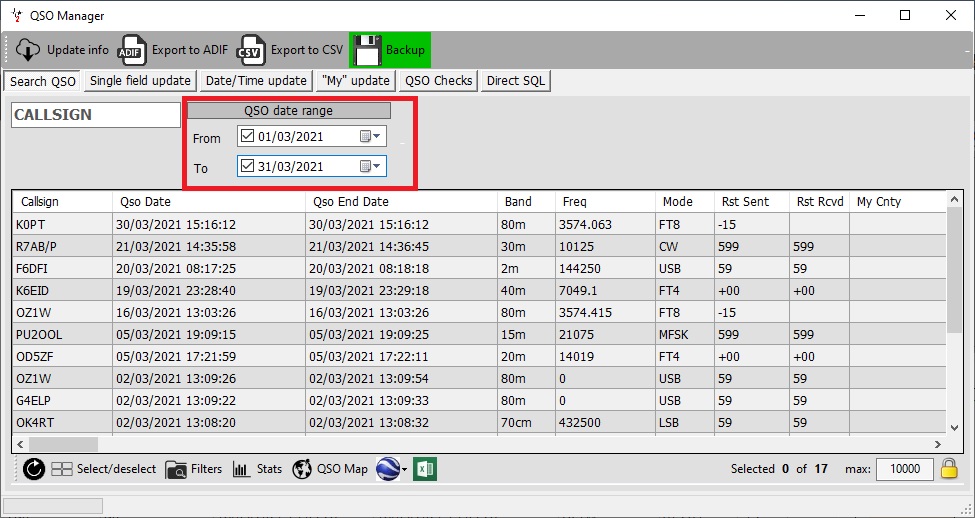

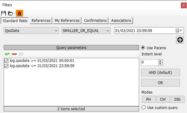

No it should be two filters, start date and end date, if in the recent QSO window or use the date range facility in the QSO manager
Normal filtering would have to be QSO date greater than or equal to (start date) and less than or equal to (end date)
Or in QSO manager
Or in QSO manager
