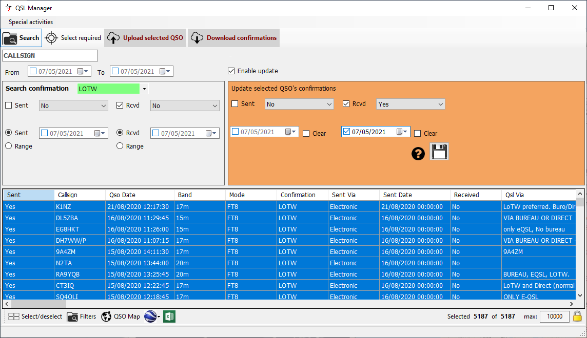

From you description I think your approaching it from the wrong screen, you should be using the QSL manager not the QSO manager for confirmation bulk edits as shown below.

Having selected the qso's and set to marking the QSO's as received =Y, click on the floppy disc save icon to update

Hello Terry,
Many thanks for your reply which I have now followed and resolved
the manual operation. Regards, Keith G3RTU
