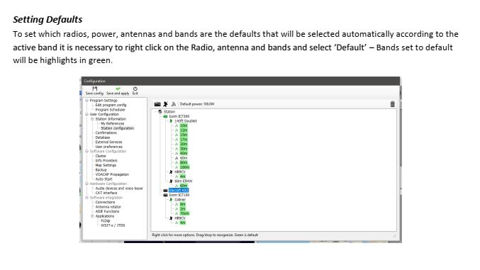

Setting defaults is possible. See page 180 of the "current" User Guide ... clip is below.
- my-station-defaults-p-180.JPG (35.77 KiB) Viewed 2761 times

Thanks Nolan and Terry for responses,
I have rig/antenna default set up correctly. Unfortunately it works only if I change band on a radio - but it does not switch radios, even if configuration says current radio does not support selected band.
