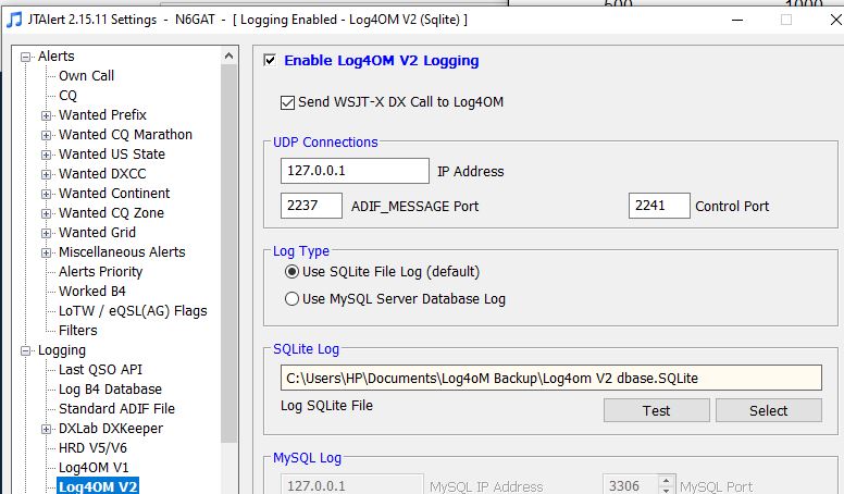

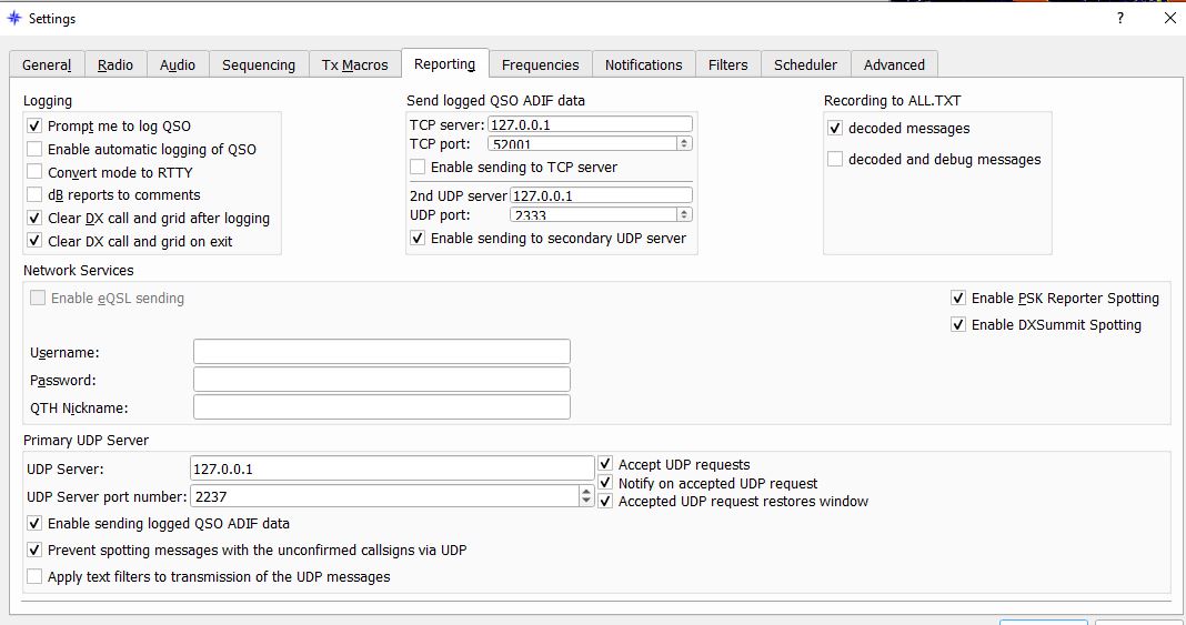

Upgraded to V2. Like the looks, but unable to log from JTAlert/JTDX. Everything working previously.
Reviewed manual and it looks like everything matches. I've attached a log file and screenshots of the configs.
I tried logging a bogus qso with callsign N6NJY. You can see where it receives it, but it doesn't go into the log.

Are you sure you have selected the correct database it's unusual for it to be located in a backup folder

Did you have set the correct UDP Inbound as ADIF_Message in Log4OM settings
at the Configuration Tab ? Log4OM V2 is looking for UDP Inbound from JTalert.
I see that you have logging to V2 enabled in JTalert so please only set UDP
inbound for JTalert. If you set it up also to UDP Inbound from JTDX you will
have double entries.

I went through the setup again disabled everything from before and tried again. Now, it does update the log in Log4om, but JTalert gives me an error each time. Will keep reading it line by line and try again tomorrow.
