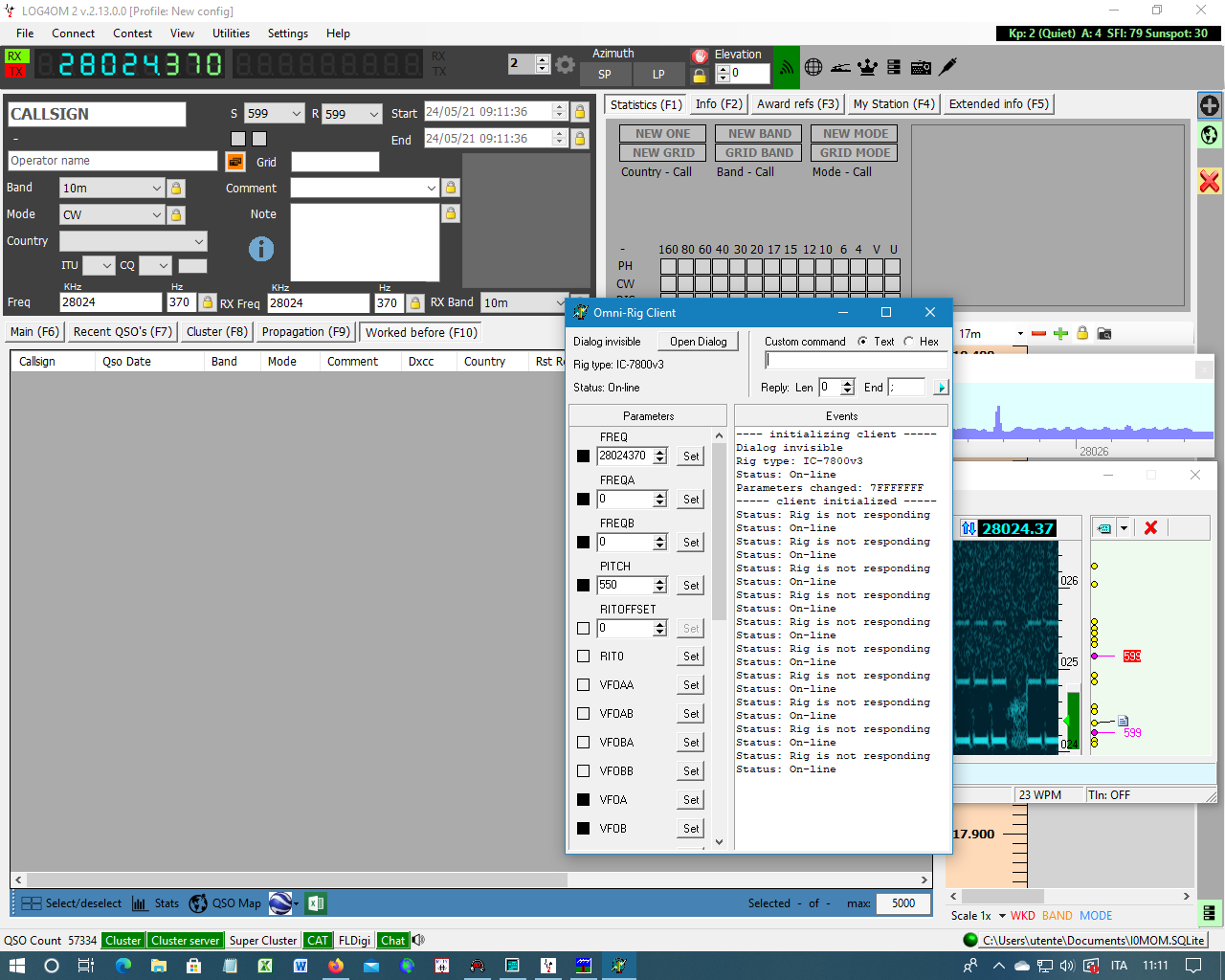

As You can see from included picture the LOG4OM CAT with IC-7800V3 seems sort of work : the rig is not seen as offline , the frequency is that of the opening of the program and all the followings frequency changes are not seen. Frequency seems locked to the first one.
I opened the OMNIRIG client program and saw many " rig not responding" messages which could explain
this behavior. Also In CWskimmer was registere the original frequency without any frequency change.
Beside, also with this ini file, I only see main frequecy displayed in LOG4OM.
