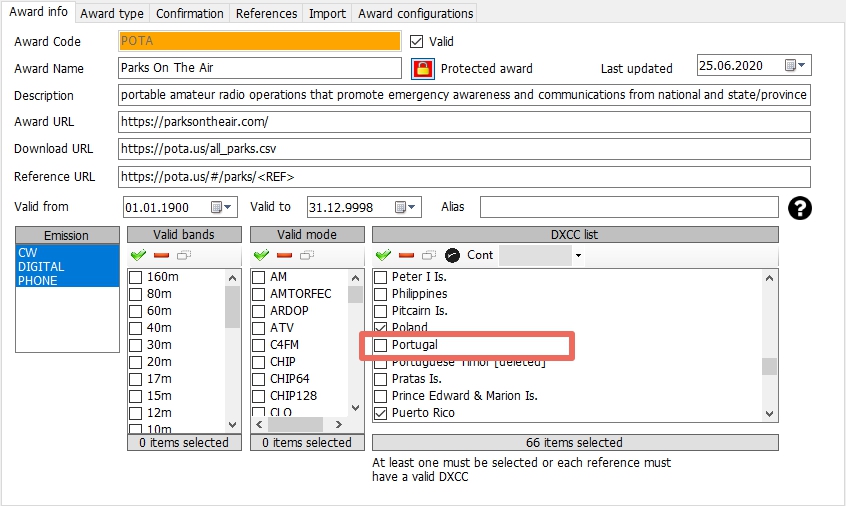

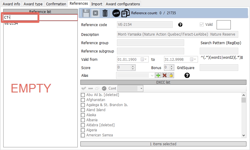

Hi Paulo,
I did some quick tests, first with a G-callsign, then with a CT-callsign. Everything worked fine with the G-callsign, but no entry with the CT-callsign.
Next I verified the POTA award in the Award Manager.
First, Portugal is not enabled in the DXCC list, which means that POTA will never be shown under Awards (F3) for any Portuguese callsign:
Second, I could not find any Portuguese (CT) entry in my POTA list under references:
But even if there are entries, you also have to verifiy, that Portugal is checked under Award Manager -> Award info -> DXCC list.
I am not sure if I have the latest POTA list, but please verify in your environemnt.
Claus
Claus
Claus, OE6CLD/DJ0DX/EI7JZ
Re: POTA / SOTA awards
That's weird.
I'm using 2.14.1.0 portable by the way.
I go to award manager, select POTA, go to DXCC list and select Portugal manually or even EU list to select all Europe, i press the floppy to "save award".
If i edit POTA again, Portugal isn't selected or any of the rest of EU countries selected in the step above.
Naturally, when i go to log, POTA isn't displayed (like i showed yesterday).
Do i have a read/write issue on the Award Manager XML or something?
It seems the issue is him not keeping my changes.
I don't have references too, i was first worried about seeing POTA itself, not references, that was the next step.
I wonder then, maybe he's not activating it on Award Manager because he's smart enough to see he doesn't have CT- in reference list?
I'm gonna try to import the POTA ALL csv they provide and test again
