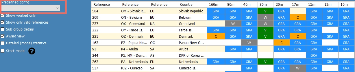

For a quick overview, you can go to View -> Award Status -> DXCC. If everything is up-to-date, you will see different color boxes: blue = granted (GRA), green = verified (on LoTW, but yet not applied for/granted), orange = confirmed (by QSL card, but not verified by DXAC or field checker) and grey = worked (worked but not confirmed by LoTW or QSL).
Under "Predefined Config" on the left you can select single bands or modes. On the Statistics tab you can see a quick overview by mode and status. For more flexibility yiou can set various filters under the "Award Filters" tab.
If you double-click on a box, you will see all matching QSOs for this band/mode slot.

I have tried all that you suggested and they work fine but as of yet I have not found a way for Log4OMv2 to tell me how many countries that I have not worked without some heave Excel work and I thought there must be an easier way from within the program. My old DXBase program did that along with "live" worked, confirmed by band and mode from the DX Cluster not type in a call. maybe you can tell me on the stats main page....phone, cw, digital the green squares does not tell me if it is confirmed or not. Am I thinking correct.
