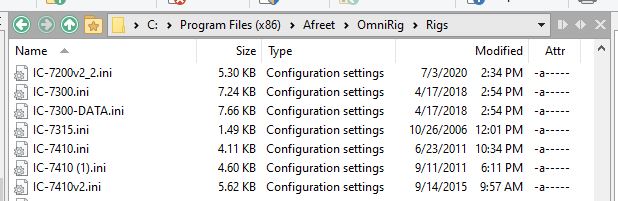

Below is a screen clip of where my rig.ini files are located. It also shows a few of the related Icom 7300 file names. My PC has a 64-bit o/s thus the location noted. 32-bit o/s uses a slightly different location.
- omnirig-ini-file-directory.JPG (42.63 KiB) Viewed 2777 times
