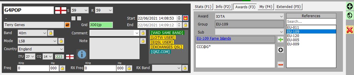

Here is the IOTA input as per our user guide
Here is the QTH data as per our user guide
Propo type is a dedicated field in ADIF and is entered here - again see user guide
