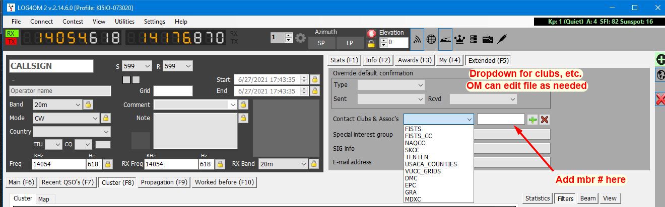

Randy,
That field already exists. On the Main UI under tab Extended (F5) it is labeled for Contact Clubs & Assoc's.
I use it to select (for example) SKCC and the OM's number to then be saved with the QSO. The blank field to the right of the label you choose is for the number for that OM.
See image below.
As for managing / importing all the ever-changing database of numbers for the clubs I don't see that happening with Log4OM. Answering such would be from Lele or Terry. FYI ... we do have the 'database list' request on our list of future possibilities so yes, we are well aware of the requests.
