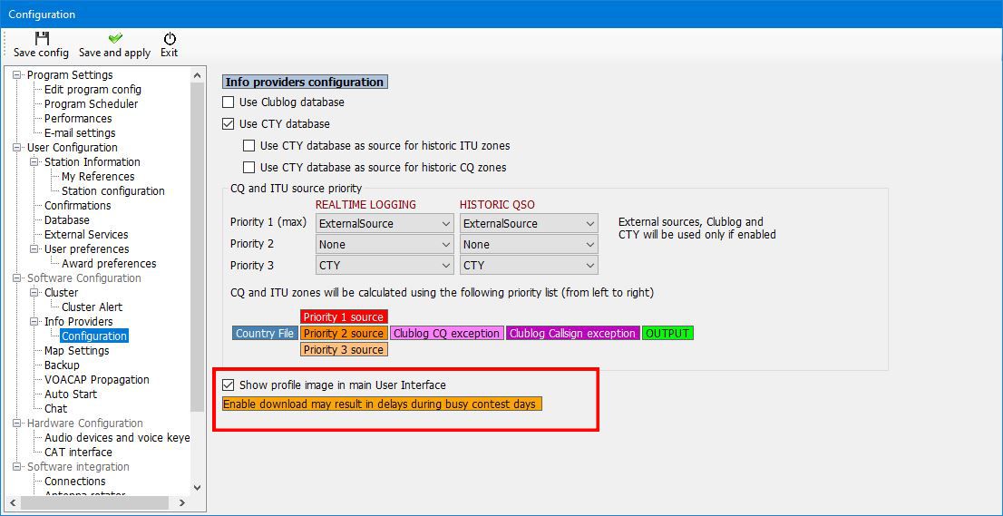

Adrian,
To view the QRZ image you must have a subscription to QRZ.com that you have paid for.
If you do have a "paid for subscription" be sure that that you have the box tic'd to "Show profile image in main User Interface" That is located at: Settings / Configuration / Info Providers / Configuration

Thank you very much Nolan, understood and solved.
