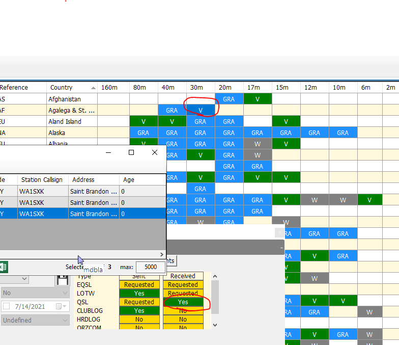

Under the Awards Status/DXCC it seems there is no way to see when you have cards that need to be submitted.
In the image is a 30M entry which only has QSL card received but the view shows Validated instead of Confirmed.

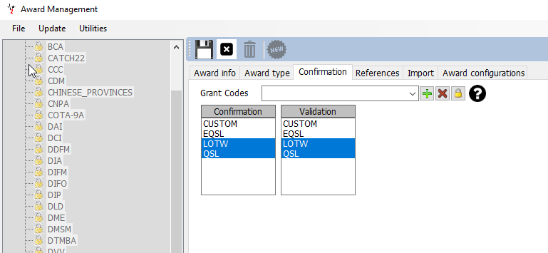

There was an issue in the LOTW configuration
This screen instructs Log4OM to consider CONFIRMED or VALIDATED when the indicated confirmations are received.
It was:
it should be

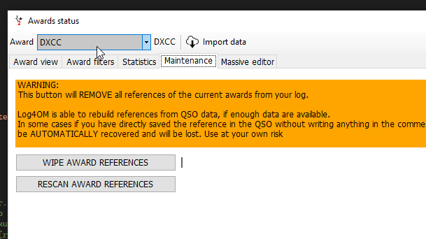

I've fixed the award. Please select DXCC in award status, then WIPE AWARD REFERENCES -> RESCAN AWARD REFERENCES.
Once done, redownload the full LOTW with QSL flag set

For my own I changed the confirmation to QSL only and validated to LOTW only.
Now all my cards show C in the awards status like I want.
