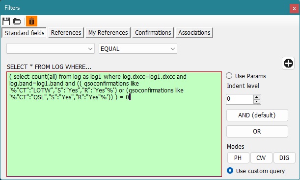

OK, just rechecked it myself. Most of the stuff mentioned in original post works when you just enter
( select count(all) from log as log1 where log.dxcc=log1.dxcc and log.band=log1.band and (( qsoconfirmations like '%"CT":"LOTW","S":"Yes","R":"Yes"%') or (qsoconfirmations like '%"CT":"QSL","S":"Yes","R":"Yes"%')) ) = 0
in the filter expression in the label print dialog, select all QSOs with ^A and confirm selection. The following dialogs will ask nicely for desired paper QSL method (direct, buero, etc..), they are even using data from qrz.com to propose the best method. Well done!

You lost me, and likely many others. Where and how is this data string entered? Will this do a screen dump, or only to a printer?

As Christian said, go to label print and select the 'Filters' icon at bottom
Copy and paste his Reg expression to the text box having first selected 'Use custom query' click the red cross to close the window and the filter will action
BE PATIENT because it will take some considerable time if you have a large log
You ca save the filter for future use in the filter dialog window for future use.
I have tested the expression and it works very well
