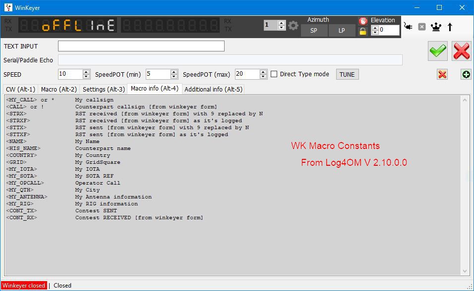

Re: REPOST: Winkeyer/Macro shortcuts
Here is a screen clip from Log4OM V 2.10.0.0 on the Winkeyer Macro Tab.
I'll look for a more recent version in case there are/were some changes.
Update: V 2.13.0.0 had the same list of WK Macro Constants.
