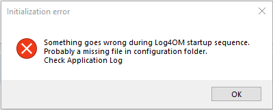

After install I get a message box titled: "Initialization error" with test about "Something goes wrong during Log4OM startup sequence. Probably a missing file in the configuration folder. Check Application Log"

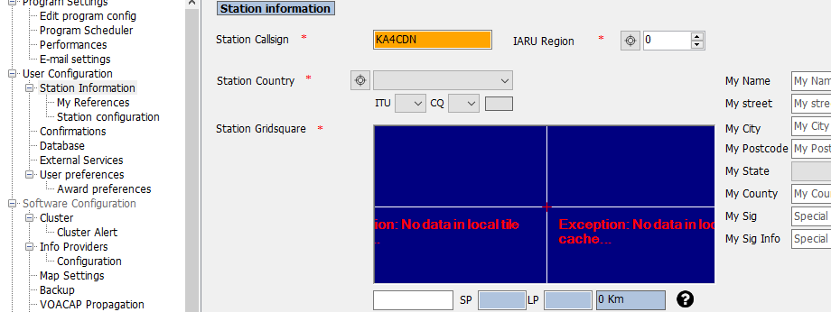

Log4OM continues to start and brings up the Configuration dialog at the Station Information page. There I can enter my station Callsign but can not set other required fields (IARU Region, Station Country, etc). The Station Gridsquare map does not show a map only the words "Exception: No data in local tile cache...."

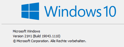

first of all is that your W10 Pro is not up to date. Latest is 21H1 Build 19043 (see attached screenshot)
