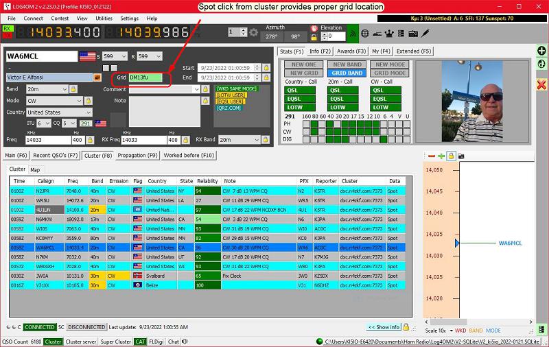

In response to Nolan's request, I am finding that double clicking on a spot in the Cluster panel updates the Main UI with 4 digit grid square only, whereas the Bandmap updates the main UI with the fuller 6 digit grid.

Paul,
Your comment/observation is opposite to what I'm experiencing. I am finding that the clicks on the bandmap spots provides a 4-digit grid value and clicking on the same spot on the cluster tab provides the 6-digit grid value.
Images of my experience are below.
As I noted in my message that the variance is not a huge issue with smaller footprint countries, but over here in the USA, Canada and Australia, etc.. the variance in the grid is a BIG difference.

Yes Nolan, complete opposite of your findings.
I can send you the screenshots if required.
Agreed, use of a 6 digit grid does not have a big impact for anyone working Northern Ireland.

Paul,mi0ayr wrote: 10 Oct 2022, 11:32 Yes Nolan, complete opposite of your findings.
Paul
Tnx for the confirmation. That really has my scratching my head now about the reverse results.
And it is very true that the grid square impact for smaller geographical areas not a big deal, but certainly is in other countries.
Yes, I'd be interested in seeing your screen clips when you have time. Pls send to my e-mail so we don't clutter up the Forum.
