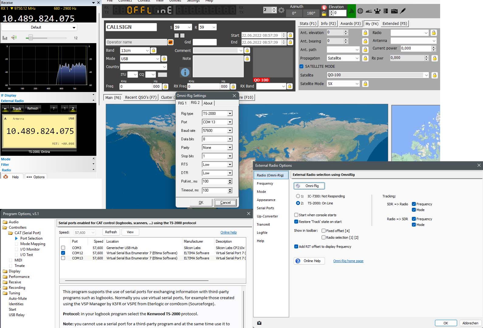

Hi Terry!
I just discovered the Omnirig option in SDR Console. I activated now the external radio. Do I have to leave the virtual comport still selected in SDR console? It seems running in SDR console but the connection to Log4OM still will not work. Here are some screenshots:
- sdr_console.jpg (236.21 KiB) Viewed 2714 times

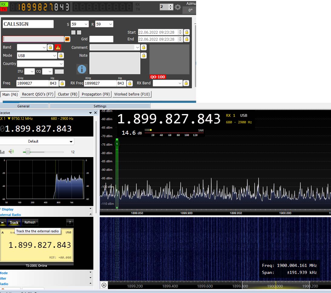

Re: Log4OM & SDR Console
After clicking onto the Track button suddenly the frequency changes. I just want to send the current frequency and mode to Log4OM so it does
not have to work in both directions.
I'm using a Pluto connected to my WiFi-Router here.

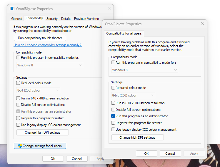

No the virtual com ports are not required
Dont forget to set all programs to 'Run as an administrator'

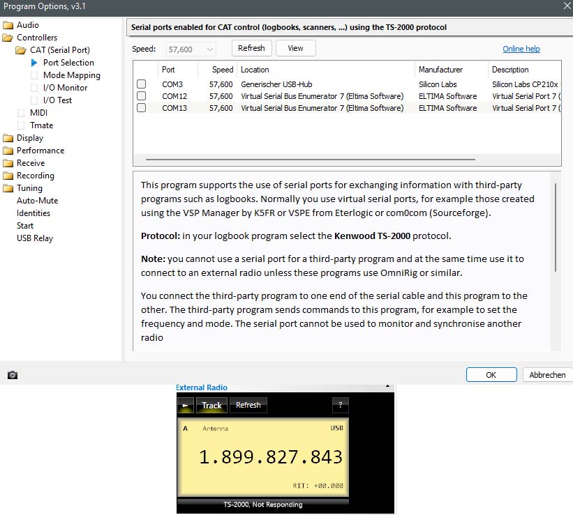

All programs are running as "Administrator". After deactivating the virtual com port the radio is not responding anymore in the
external radio window...
- sdr_console3.jpg (126.24 KiB) Viewed 2710 times
I expect that you have the radio connected to a Virtual com port in Omnirig instead of the physical port to which the radio is actually connected.
It works like this.......
Omnirig makes the physical connection to your radios
Log4OM and SDRConsul share the data from Omnirig using its multithreading capability
You may have up to 8 programs all exchanging data with Omnirig providing all of the programs are set up to run as an administrator in their program properties/compatibility/settings (No virtual com ports required)
