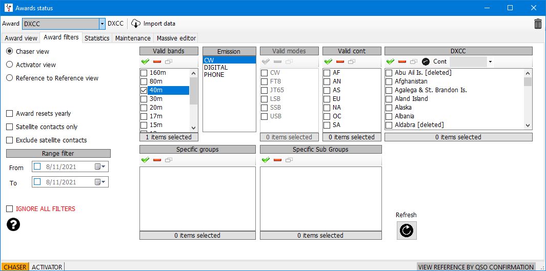

Is there a way to get a list of countries that have been granted by band and mode and not just a list of grid squares that you have to go through one by one. Basically a report without having to export to Excel and then play with it to try and get what you want. I am not a programmer or computer expert but I had this and many other reports in my former logging program (DXbase) but DXbase in no longer. The owner just up and quit a couple years ago.

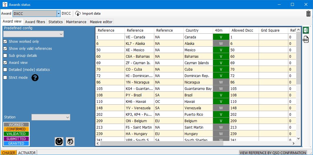

Greg,
Have you looked at: View / Award Status ? You can select an award (IE: DXCC) and then set filters to further delineate the default view. The two images below are from my DXCC Award and then I selected CW for Mode and 40m for Band. Tapped the refresh and got the result that is visible in the Award View tab.
That might be a help for you.
