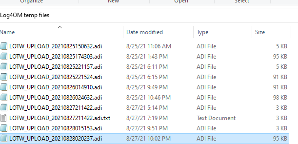

Attached is the log4OM temp files listing, Upload screen, and the corresponding LOTW activity Record
for a of 96 call signs.
Log4OM Temp file

Re: Log4OM uploading QSOs that are LOTW duplicates
That's a weird thing... why LOTW enters a "suppression mode" if the output is intended to deal with an application?
Crap...
i'll search for a solution, thanks for the info
