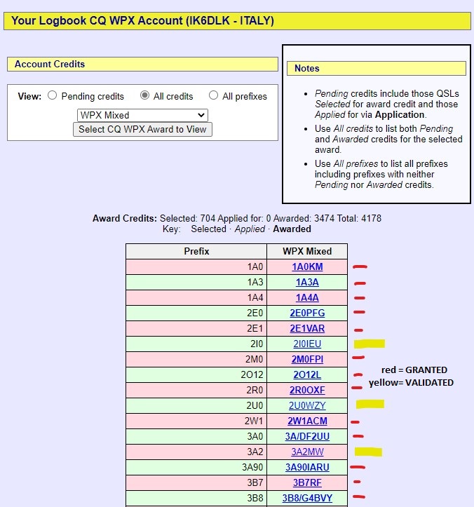

this is ok, I have all QSL validated but not the Granted ones even if in LoTW they are reported.
Look at pic
Thanks for the attention.

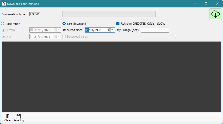

Try another download with a very early start date and the download QSL box checked as below

Retrieve credited QSL checked?

Tarry, give me more info on how to do this.
TNX Fabrizio IK6DLK
Posts: 11594
Re: WPX LoTW QSO Granted
See my image in previous post its the check box marked as described
