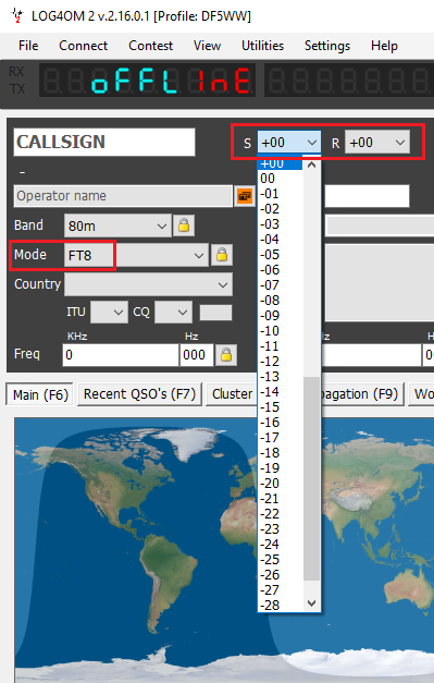

Normally there isn´t to do something wrong. That informations coming from the rst file. It´s an XML and stored
in the Log4OM configuration folder. What version of V2 you are using ? (See Help/About).
As you can see in my screenshot it works well on my side:
You may also try my rst_user file. You can copy it in the folder where you find the rst file. You don´t
have to delete the original files so _user files override the original ones.
