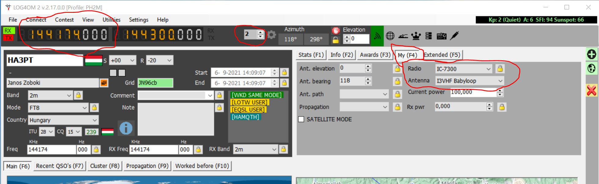

I 'am running 2 rigs via omnirig, together mainly in FT8-mode with JTDX & GridTracker, finished QSO's are logged in Log4OM via GridTracker.

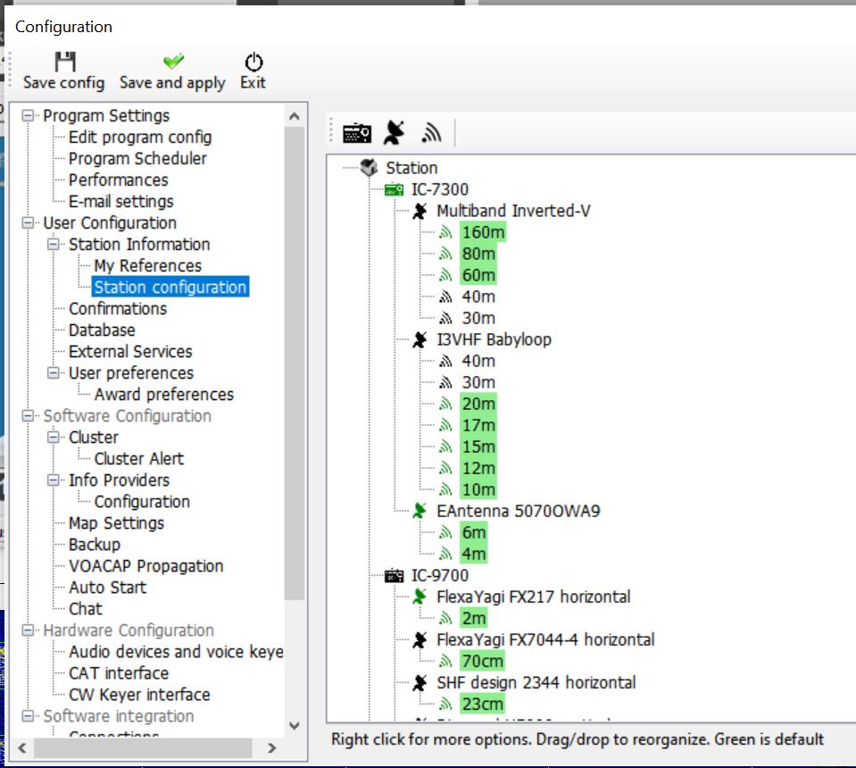

So I' am running mostly 2 rigs together at the time (in Log4OM as Rig1 + Rig2) but in My (F4) I can choose only ONE Radio + Antenna setup, this causing when I log a QSO on HF and then a QSO on VHF both QSO's logged as using my Primary Radio: IC-7300 and Primary antenna EAntenna 5070OWA9
How can I log each QSO with the correct MyRig & Antenna used per band ?!

You cant but perhaps try running both the portable and the installed versions of Log4OM concurrently - One for rig 1 set up and the other for rig 2 setup
