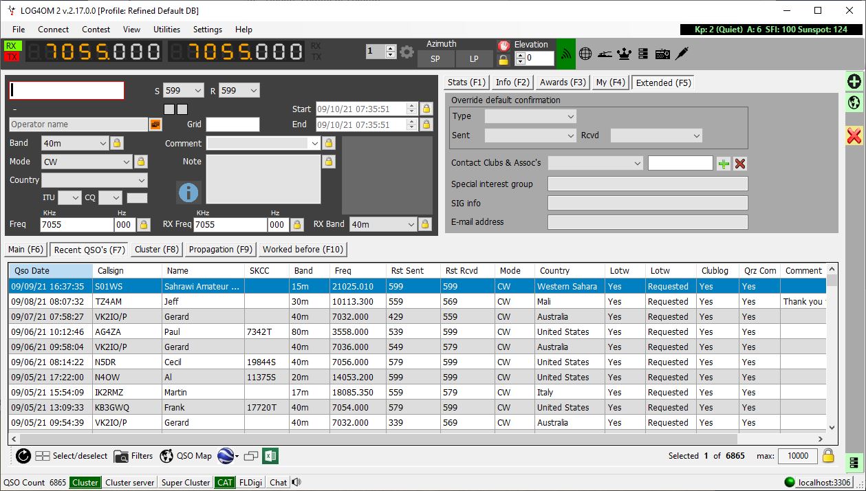

Hi Rich -
I also use Log4OM2 as my daily log and then export the SKCC contacts into SKCC logger to keep the skimmer and process awards etc.
I set Association 1 to SKCC - enter a stations particulars on the F5 Extended page and then change the label on the Recent QSO listing. See photo.
Every week or 10 days I simply select all QSOs which have an entry in the SKCC (Association 1) field and export them to ADIF, then import them into SKCC logger.
