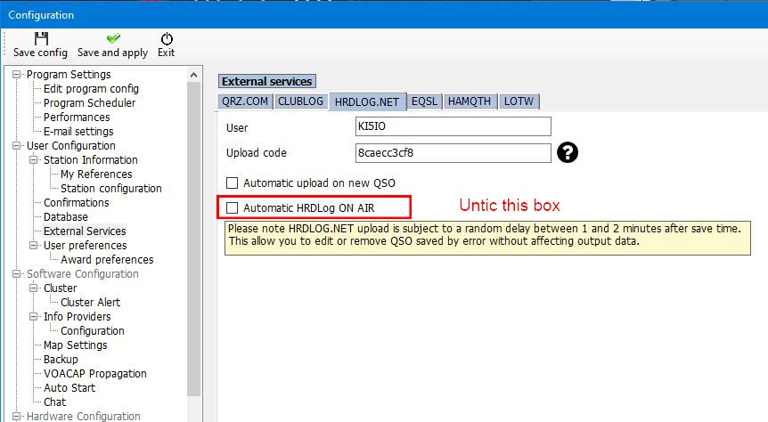

Hello fellow LO4OM users.
I would like to know how I can turn off the autospot of my own call. It seems that when I use the Supercluster, which brings in the spots of logged calls via LOTW, I also project myself onto the cluster as PD5JOS without any spotter. Friends always asked me why are you doing this. And because im searching over the band the info/freq is always outdated. I would like this feature to turn off, anyone know the solution?
'73 Jos de PD5JOS

Jos,
It is possible that you have the HRDLog "on-air" box tic'd.
Look at: Settings / Configuration / External Services / HRDLOG.NET

Hi Nloan,
Yes that box was ticked. Now unticked, hopefully this will solve the issue. Will let it know. Thanks

Hello Nolan,
Thanks for the suggestion with the Tickbox in the HRDLOG.NET setup, that solved my problem. Don't think many OM does know this, is see many station with no SPotter on the cluster in Log4OM, must be the same issue they have.
Verry happy with this,
73, Jos de PD5JOS
