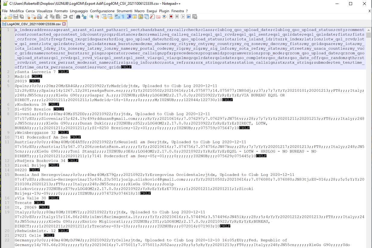

Good morning,
i tried to export all my logbook (less than 1000 qso), but i get a totally wrong data at least in the first lines.
Attached screen shot I see.
Maybe am I wrong something?
Roberto

So the problem is in the Carriage return-Line feed (CR-LF) characters found at the end of the first two lines of each exported record.
The csv file should have only one cr-lf at the end of the record as its component fields must be separated by;
This "error" only happens if I export the file asking for all the data base fields, if I ask for only a part of the fields the file is correct.
