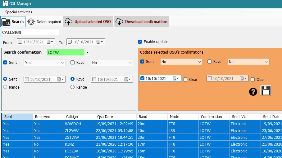

One other question, since this is a work in progress, I'll be importing calls from the old call a few times before I want to upload them to LOTW. I did a bulk edit to add or change the STATION CALL, to my old call. I also want to set the "flag" for LOTW uploads to NO. Once I'm done, I can do a bulk edit to set the LOTW flag to upload them all at the same time. I've checked the bulk edit, single field, and I didn't see any LOTW fields listed. Can LOTW do this?

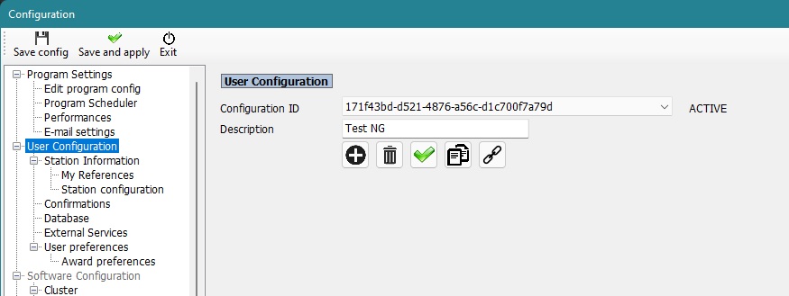

Re: LOG4OM / LOTW and Multiple Call Certificates
I meant a separate Log4OM config and you can edit the LOTW sent status in QSL Manager - See images below to illustrate both issues.
