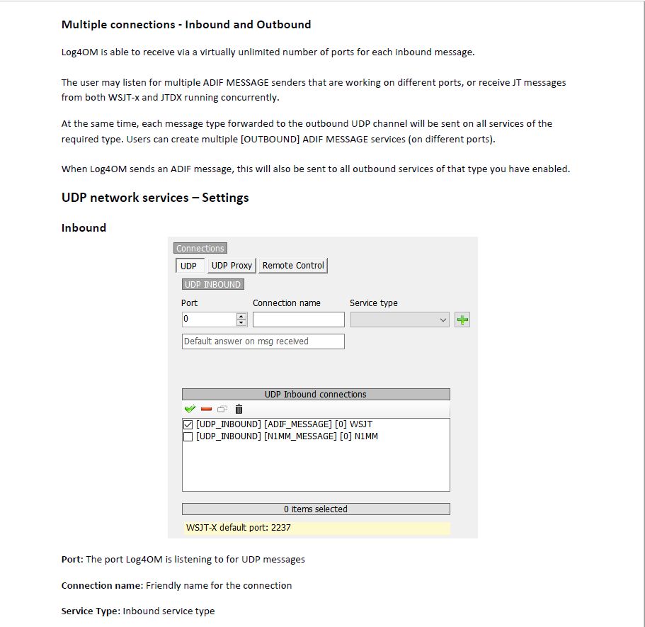

Look on the manual on page 168.
wsjt-x UDP.jpg (80.59 KiB) Viewed 1831 times
Maybe this will help.

Many thanks for your help. When I type in the entry as shown in the user manual the press the + at the right, nothing gets transferred to the box below as shown below. Interesting that my user manual stipulates [UDP_INBOUND] {JTMESSAGE[ 2237] WSJT DIRECT however I have the same problem that pressing the+ on the right does not transfer the entry to the box below.

(1) Normally you have to enter your port number first.
(2) Then give a name to that connection and (3) then type the service.
When that's all done, (4) press the plus (+) sign.
If everything was entered correctly, you should see entered data in the bottom box at UDP Inbound connections.
This is how I did it in version 2.17.0.0
73 Patrick ON6AT
