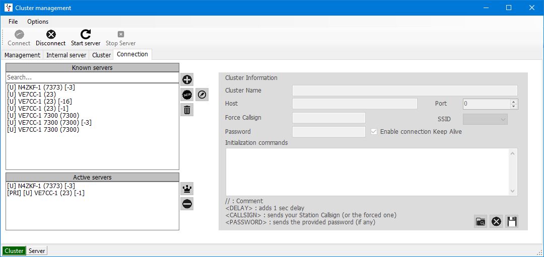

Phil,
What have you set up at: Connect/ Cluster Management / Connection
I am using connections to ve7cc and n4zkf and they are controlled via the CC User platform. I can set all sorts of filters at CC User for both ve7cc and n4zkf and will run both at some times and sometimes not.
Image below is of my current active servers. BTW - I have selected to show "User Defined Clusters" in my setup. You can control which Clusters to view at: Settings / Program Configuration / Cluster
- Cluster-Mngmt.JPG (72.28 KiB) Viewed 2433 times

Hi Nolan
In looking at the image you sent I cannot find 'cluster management' anywhere in the program. Where do you find that?
Re: sending spots and clusters
Phil,k2jf wrote: 16 Oct 2021, 16:12 Hi Nolan
I messed up on my path: Connect / Telnet Cluster (opens Cluster Management panel) / Connection
If you have not changed server views in the configuration location I noted you will see a full list of all active servers that Lele has loaded as default with Log5OM V2. Of course you can add any yourself that may not be in the list.
I really like the ve7cc cluster and it's filtering capabilities via the CC User controls.
BTW - Detail information about handling the clusters starts on Page 64 of the "Current User Guide".
