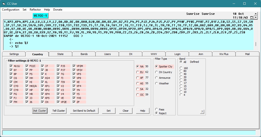

So the thing is this: I have a modest station in NYC. 100 watts and a 20m dipole up 85 feet. All I'm interested in is chasing cw dx to Europe on my free afternoons. I have the Ve7CC cluster as the only one on my list right now. Looking at the filters I have CW and 20 M checked. Then my two choices are either spot origin NA or spot origin EU. When I have it set for spot origin from NA I see both NA and DX. and when I have spot origin from EU the reporters are from Europe but the stations they're spotting are from EU and from NA. How do I get see only EU spots from spot reporters who are in NA?

What you need to do is specify to whichever cluster you are listening to to ignore DX from K. (Something like "SET/FILTER DXCTY/REJECT K" - I use CC User so not sure of your exact situation).

If your using VE7CC then you need to download the VE7CC CCuser software and set up filters in that software to reject and accept calls as you require.

need your help still. I downloaded the ve7cc program and tried setting filters. I'm looking for the simplest thing: how to see spotting stations in NA that are spotting DX stations on 20 and 40.. that's it. I looked through everything and still see reporters from the US which is what I want but too many of the stations that they're spotting are also in the US!

Pass spots spotted only from NA
and
Reject DX Spots in NA
So your saying I only want to see DX that was spotted by a spotter in NA but I do not want to see any DX Spots in NA which results in DX spots from outside NA that were spotted by a spotter in NA only being displayed.
Dont forget to sent the filter once selected

I use CC user and set the filters to my liking and in the ve7cc cluster link put sh MYDX instead of sh DX.
