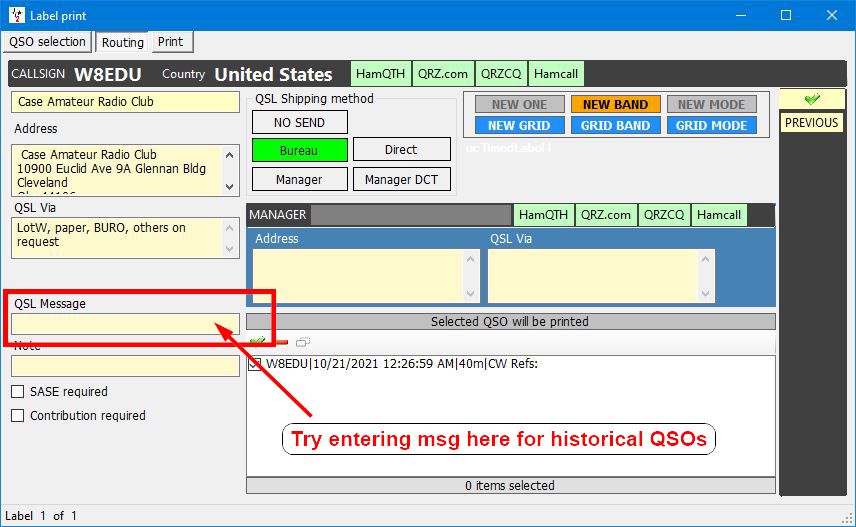

Maurizio,
Try entering message at this location when selecting QSOs for printing ... "historical" QSOs.
I did a test this AM and it worked for me.

Hi Nolan,
I tried it and it works also for me for "historical" QSOs.
It could be the right workaround.
