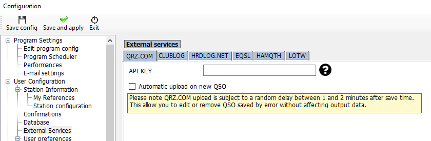

Re: Missing ClubLog update with imported adif
Clublog does not have an API Key. The only known service with and API is qrz.com but it
only works if you are a xml subscriber.

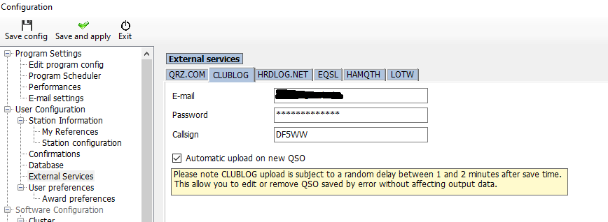

ZL2UB
What i mean is an API for Clublog in the Log4OM configuration. There is only one for qrz.com.
