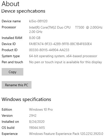

I'm sure other OMs will chime in with suggestions with respect to computers. Current high speed processors, SSDs, plenty of RAM and on and on. I've shopped around a little bit, but my budget won't allow for a new PC at this time so maybe in the future I'll be able to get one. When the time comes I may get a small format mini-tower for my ham radio use as opposed to the laptop I currently use.
In fact, my current laptops (between my wife and I we have 3) are all very old and none of them even qualify for the minimum requirements for the new Windows 11 O/S.

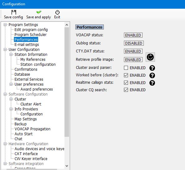

That being said you can adjust a number of items in Log4OM V2 that can tailor your usage as it comes to performances. Mine will slow down a lot during the various weekend special events and the clusters are overloaded with traffic. That really slows my system down, so I adjust just what all the cluster feeds Log4OM V2. I can easily tailor that via the CC User APP as I mostly use the VE7CC cluster.
I've put a screen clip of my "aged" Dell D830 laptop specifications and I've also copied my current "performance" selections.

Re: Why so much Ram usage
Nolan -
Although I'm not, in general, having issues with performance of Log4OM2 this post of yours is great and I have modified my settings to be more in tune (pun intended) with my own activities.
Just wanted to shout out a thank you for the advice.
