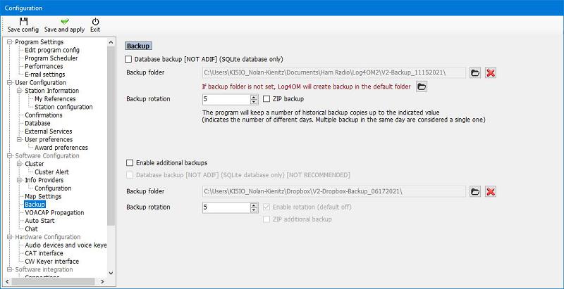

Trevor,
You can set all your backup options in the Configuration file.
Sample image below ...
- config_backups-medium.JPG (53.52 KiB) Viewed 1960 times
