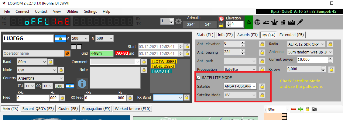

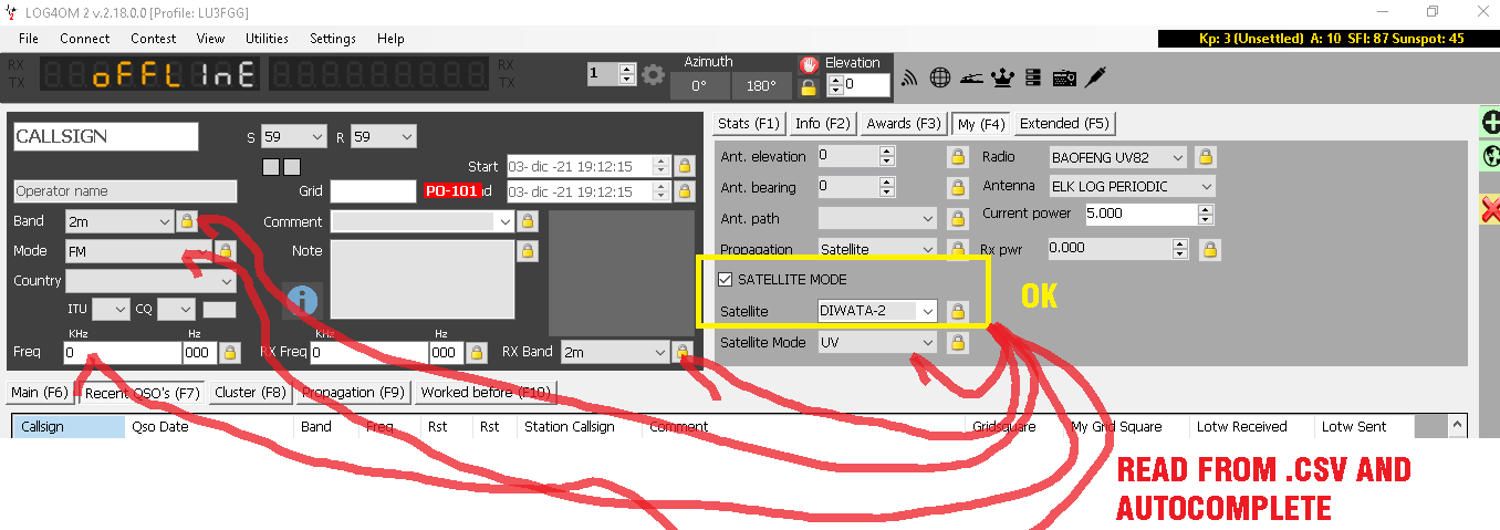

Hello, I wanted to ask you if the following fields, can be added to the satellites.csv file "Satellite Mode" ; "Band"; "Mode"; "TX Freq"; "RX Band" and have it autocomplete:
DIWATA-2,PO-101;UV;70cm;FM;437500;2m
Saudi-OSCAR 50;SO-50;VU;2m;FM;145550;70cm
AMSAT-OSCAR-91;AO-91;UV;70cm;FM;435550;2m
AMSAT-OSCAR-92;AO-92;UV;70cm;FM;435550;2m
ARISS;ARISS;VU;2m;FM;145990;70cm
Mainly for those of us who manually complete each satellite qso.

DIWATA-2,PO-101 is sadly not in the log4om "satellites.csv". Not sure what to enter there to make it LOTW conform.
Also in the satmodelist.txt the mode "V" is missing for APRS and PKT QSO via ARISS. I modified the mode by hand.
Edit:
For the QRGs: I also add both QRGs for every QSO manually. Would be a nice feature to have the SAT QRGs pre-filled after one chose a SAT in LOG4OM.
Edit 2:
I manually added Diwata-2;PO-101 to the "satellites.csv". Let's see what happens on LOTW.

Frequencies will be filled only when CAT is connected. Otherwise you have to entering the
frequencies by hand.

DF5WW wrote: 04 Dec 2021, 08:59 Frequencies will be filled only when CAT is connected. Otherwise you have to entering the
Yes sure. But the feature request ist to pre-fill the QRGs in Log4OM based on the table. Every SAT has a fixed QRG, so that would be technically possible. I would put all the QRGs and default modes into the table if that is needed.

Yes that is a nice idea that has been requested already we will discuss it
