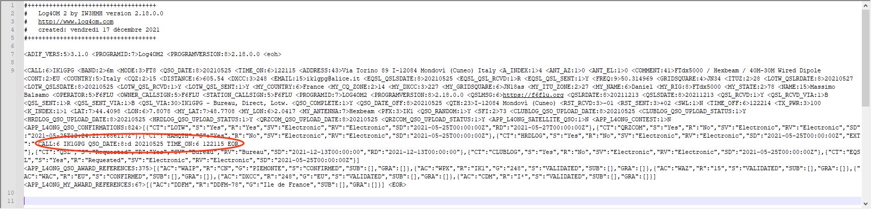

I create a file by sorting on the QSL Sent = Requested field via the QSL Manager utility and export to an ADIF File
When I look at this export, on some QSOs and only on some QSOs I have the Call QSO-Date Time-ON and EOR fields which are repeated in the middle of the recording and these fields do not have the delimitation of a ADIF file, the < and > do not exist. :
Example : CALL:6 IK1GPG QSO_DATE:8:d 20210525 TIME_ON:6 122115 EOR
Obviously this poses a problem when managing such a recording.
I also attach you the global file with at the end of the file this kind of error on different callsigns
Thank you in advance for your advice
