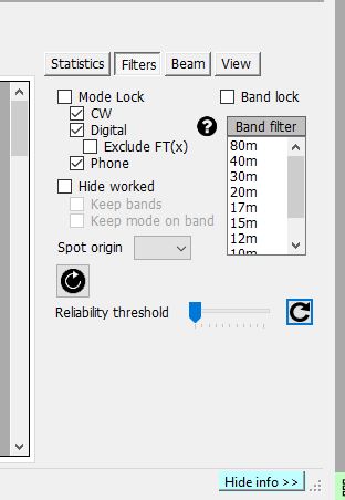

Check your "Reliability Threshold" settings on your Cluster panel windows. I find that if I have that slider moved to the right there can be a difference of spot display as I compart the cluster view from the Cluster Management Panel side by side with the Main UI cluster. Each have their own "Reliability Threshold" settings.
I keep mine typically at the far left and once I move the slider I tap the button to refresh the reliability filter.

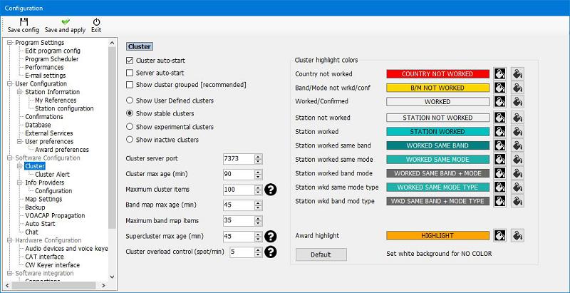

I've also include a screen clip of my cluster settings. My Cluster Overload Control (bottom item/value) at 5 as that helps throttle a high volume of spots so that it don't overload my CPU as much during those high volume events.
