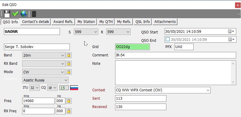

I have for example a QSO carried out with UA0SR on 05/30/2021,
this QSO is validated by LOTW and yet Log4OM displays that this QSO is in status "W" and not 'V "
I do not understand why

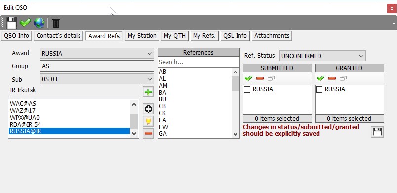

Awards depends on the confirmation status of each QSO.
"W" means worked, so if you look at the tab "QSL Info" you surelly see the contact wasn't confirmed yet.
Take a peek on the "Award Management" on the Confirmation label. It seems to only accept CUSTOM or Paper QSL.
So I think ifyou get the confirmation via LOTW the status on the award will be Worked and not Validated.
It depends of the loggic of each Award.

Thank you Claudio for your comment, yes indeed I did not publish the good screenshot here:
We can see that the QSO is validated via LOTW
for the moment I don't want to touch the XML file I just want to know if it's a problem with me or if it's a Log4OM problem ?
