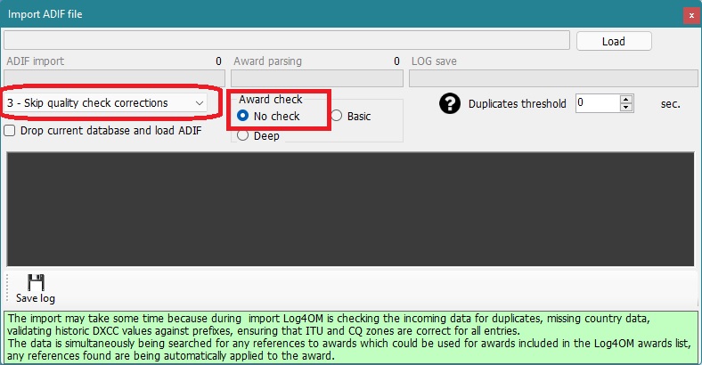

Does not specifically mention grid squares it says no quality checks and none as shown below
This is relevant to ADIF import whereas a UDP transfer does not update any information already present just fills where data does not exist - e.g. N1MM does not include country or DXCC data in its UDP transfer, we append that missing data.
G8LIY
Posts: 56
Joined: 02 Jan 2020, 08:18
Re: GRID Squares during Import or UDP Transfer
Post by G8LIY »
Many thanks...
Now understood :)
Dave
