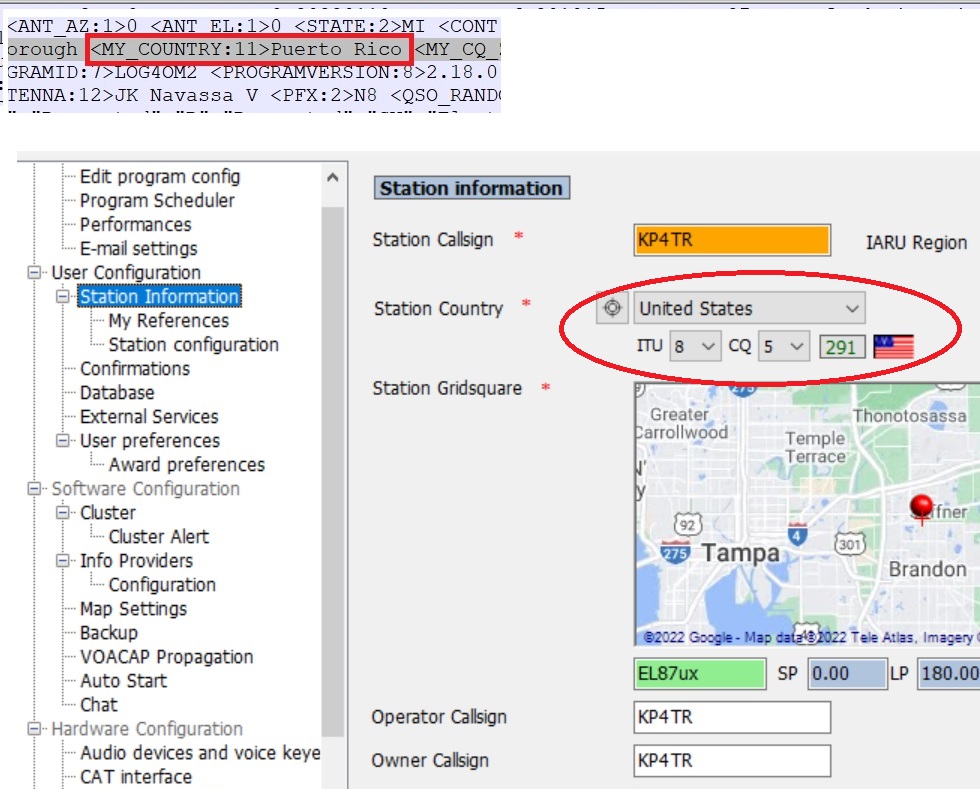

I noticed my ADIF files being uploaded have the wrong country. Attached is an example of the ADIF entry and my setting in LOG4OM.
Any idea why it is being "corrected"? I have a Puerto Rico callsign but I am in Florida.

Where did the original QSO originate, some type of WSJT software?

Re: ADIF files setting <MY_COUNTRY> incorrectly
Post by kp4tr »
Version 2.18.0.0
I use WSJT-Z. Let me look into that cause when I logged manually with a SSB call, it logged correctly.
Thanks for pointing that out.
You should also use the integration method detailed in our use guide for connection to WSJT
