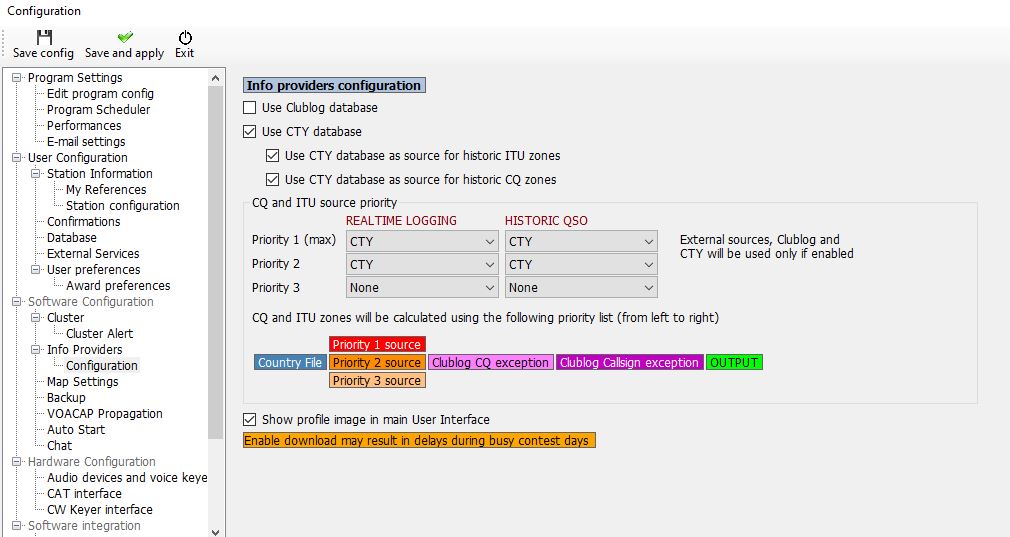

When I enter TO6S I don't get any country or zones shown.
Any idea what may be going on?
Thanks,
Mike, NE8P
I am configured as follows.
Other calls I enter return country and zones correctly. I've verified that TO6S is correctly identified as in FG per the latest CTY file (and has been correctly IDd in CTY file since 29 October.) TO6S: No Country or Zones Shown

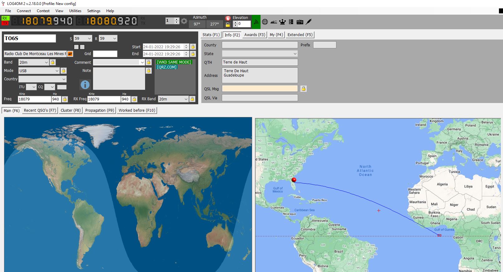

I put in TO6S and I get Guadeloupe ...

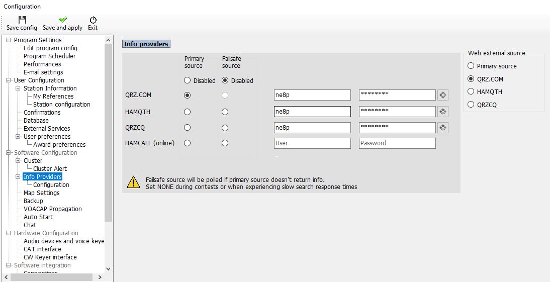

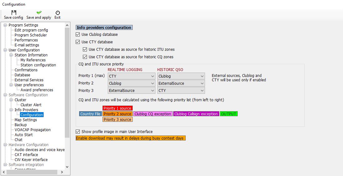

I also use QRZ.com as my main external source and my Information Provider Configuration is noted below.
I change my Info Provider Config from time to time as well.
I also reset my Info Provider Config to match yours and I got the same valid data as noted in the Main UI image below.

Nolan,
Thanks for the information. I also reset my Info Provider Config to match yours, and I still have the same issue. Strange thing is that when I enter other callsigns, it seems to work as it should.
It is pulling some information from somewhere because it has the operator name as QRZ.com has it, and the Info (F2) tab has Guadeloupe address info in it. I'm just not getting country and zone information....

Also, I need to correct a statement I made earlier. I am NOT a paid QRZ.com subscriber.
However, I'm trying, and the published priority is, to use the CTY file to pull country and zone info from. I've manually updated the CTY file using Settings -> Update Resources -> Country File, and the results are still the same. It's like the CTY file is not working here.
Mike
I'd already downloaded and installed V2.19.0.0 with the same results here.

Setting my Info Provider to HAMQTH does result in correct information for AH2O and DP1POL. Unfortunately, TO6S is not in that database. So it looks the same as before. It's simple enough for me to change the Country to Guadeloupe in this case, and in other cases in the future when such calls as TO are used. I was just trying to find an automatic solution.
I still don't understand why the CTY file is apparently not being used. I've updated it and verified that the country and zone information in the latest AD1C CTY file is correct for TO6S (and for DP1POL and AH2O, as well.)
