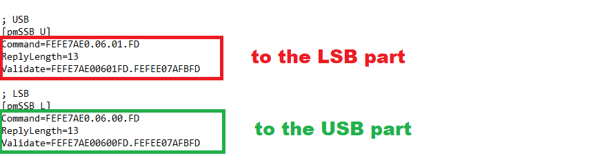

Re: usb & lsb will not match
Go to the Omnirig rig folder. Searcht the .ini file that you´re using with omnirig. Open it with
a editor like Notepad++ and change the CAT codes for USB and LSB.

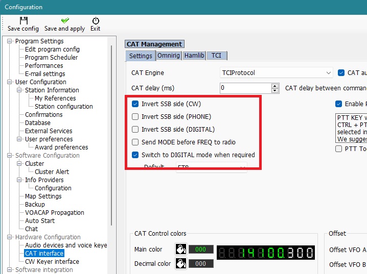

- Posts: 11593
Try changing the settings on the configuration/CAT - see below
