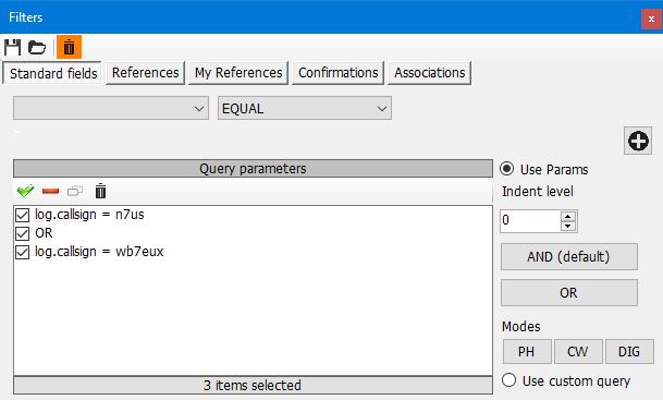

You can change the default "and" to an "or" and you can get the callsigns by just using callsign = option. See image below.

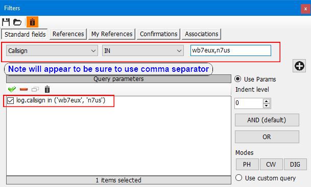

Or you can select 'callsign' (as you did) and the choose 'IN' filter selection and then enter your callsigns in the right field that opens up. There were be a brief splash sign advising you to separate each value with a comma.
Enter in the callsigns separated with a comma (I just tried and did not use any spacing) and then do the + sign to add to the query parameter box.
